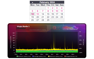

Good afternoon,
I've had some issues with my broadband over the last few weeks.
  1. I run separated 2.4ghz and 5ghz bands and have done for years. Lately the 5ghz band keeps disappearing completely.
  2. My main PC uses an ethernet connection to the hub, but I've been experiencing frequent disconnections. I often work from home and have been dropped out of a number of meeting recently, which just isn't acceptable.

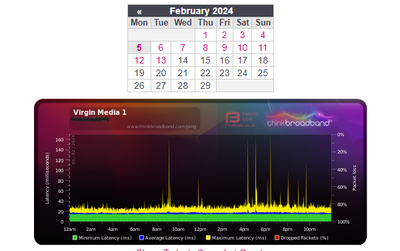

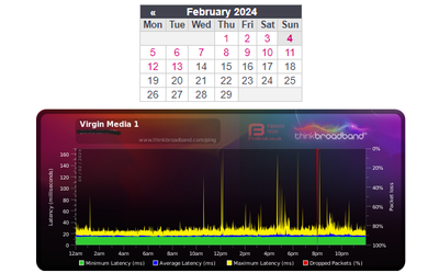

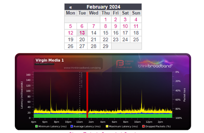

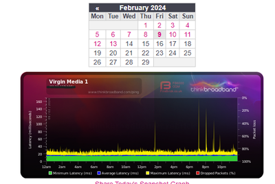

Some examples below (I've been disconnected on everyone of those latency spikes):
9 Replies
