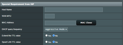

    If this fails you can use a setting called 'MAC Clone' on your Asus WAN settings, and enter the MAC address of your laptop's ethernet adapter.
  • Use the below command in an app called 'PowerShell' to find the MAC address on your laptop:
    Get-WmiObject win32_networkadapterconfiguration | select description, macaddress
    • AndreasGH's avatar
      AndreasGH
      Interesting! Would ipconfig /all provide each adaptor's mac address also (physical address)?
  • Just one further note (Cannot edit posts anymore!) if you set the MAC address to be your laptop's your public IP address will change, so if you access anything remotely you'll need to make a note of the new IP.
