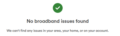

      This has been happening for a couple of days. Sometimes when I do a service check it says "Everything is fine", other times it says "Intermittent signal". So not sure if there is a problem in the area, sometimes it's saying that everything is fine apparently. This has been happening for a couple of days now.

      I did do these steps yesterday as well, by just going on the online status checker and it it gives the same steps and says they are apparently aware.
      Though between then and now, I have done the status checker several times where it says that everything is fine (not intermittent signal).

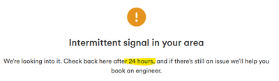

        Checking the systems on our side we can see that there is an intermittent issue affecting the local area. We also aren't able to run the full checks whilst the router is in modem mode.
        Do you currently see the same service issue information on your side? If not, and you're still experiencing issues, please place our hub into router mode and we can run further checks.

  • Ok, frustratingly, it still isn't working and I had been getting the "Intermittent signal in your area" message on the Service Status page, and it was counting down from 24 hours, saying that after 24 hours it will help to book an engineer. It counted down all the way down to around 1 hour, and I was waiting for that message to book an engineer. So I run the check in 1 hour, and annoyingly it says that everything is fine:
    However, the issue is still there. I run the service checker again and I get the Intermittent Signal message again, except now the counter has restarted back to 24 hours until they can tell me how to book an engineer again!
    This pattern has been going on for 3 or 4 days now, the internet is basically unusable and they never let me get to the stage of finding out how to get an engineer, it just resets the counter.
    Any idea how I can get an engineer around?
