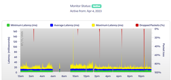

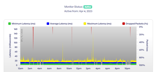

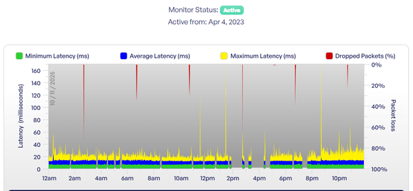

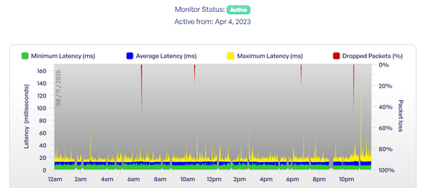

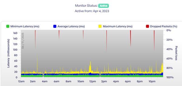

  • This post has my screenshots of the broadband quality monitor
    https://community.virginmedia.com/discussions/Wireless/hub-5-recurring-t3-timeouts-causing-intermittent-connection-drops---log-attached/5681001/replies/5681625
