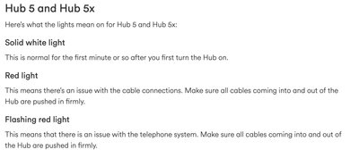

    According to the guide (below), flashing red light just suggests a telephone connection issue.  Do you have a VM landline and is that connected to the telephone port on the back of the Hub5?
