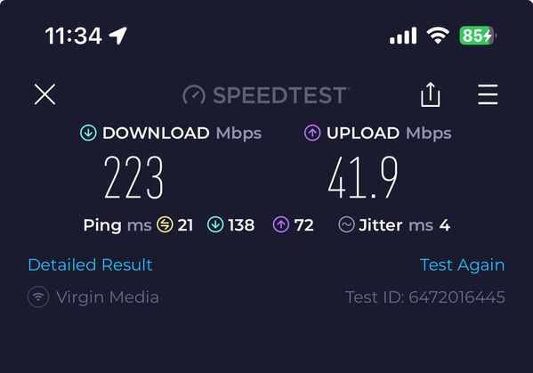

  • I know some of you are saying itโ€™s not possible but I literally just got these speeds on a hardwired nova MW3 through my virgin hub5 in modem mode, very strange !
