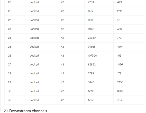

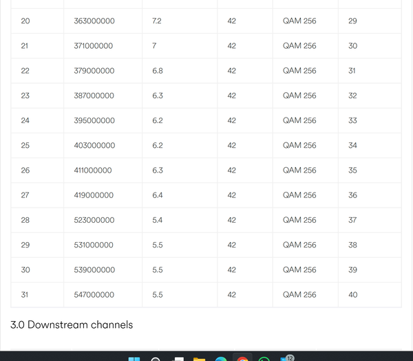

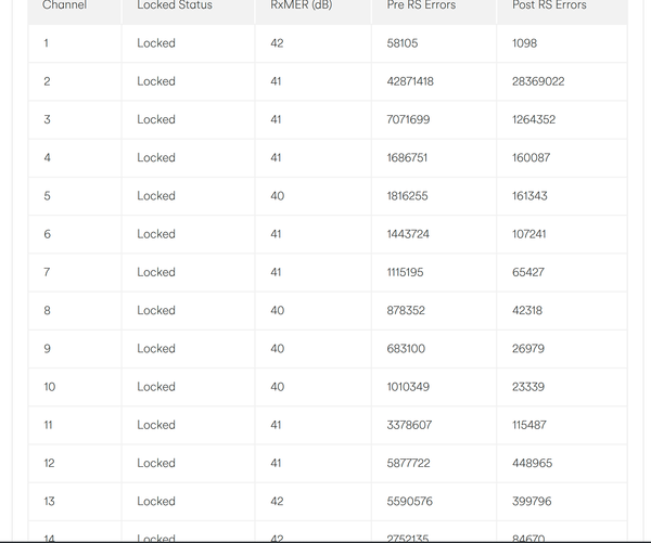

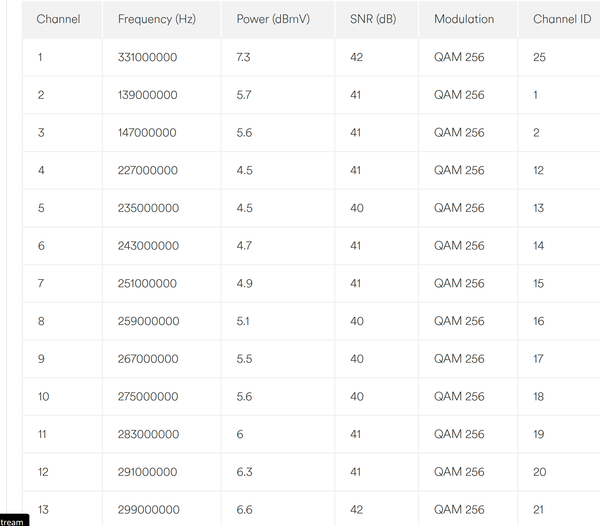

High power levels and thousands of uncorrectable errors
Back to this mess again after a couple of years of stability, going to guess some techs moved my power tap to push me to the limits to bring someone else back into spec. Internet hangs all the time, pages don't load, online gaming is a joke...

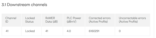

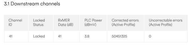

    Straight after a hub reboot and 15 mins later...

  • Power is fine, problem is noise, whether because wanted signal is too weak or there's a high powered noise source.

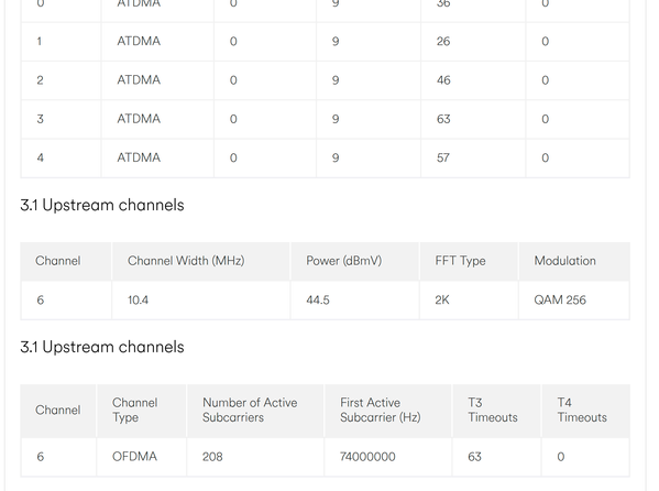

    Upstreams are very broken, your worst downstream channel is the one closest to the upstreams in frequency.
    Don't think this is a widespread issue: the DoCSIS 3.1 upstream is 256QAM and the downstream 4096QAM. Suspect the issue is either in or close to your home and no further away than the cabinet your coax goes to. I include your Hub as a possible cause here, in fact a likely one.

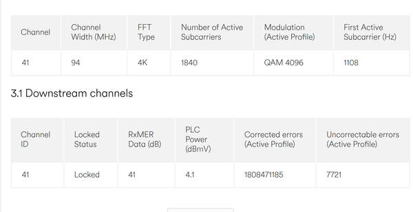

    1.5 billion uncorrected errors since reboot now....

        An engineer came yesterday, agreed that 4 billion corrected errors is an issue in 36 hours, replaced filters, checked the install back to the cab, no issue until the cab.
        He did try to say it was all done until I pointed out that within a minute of the reboot a million corrected errors were logged, I am on the limits power wise, he only just got upstream into check and assumed that would help.
        Nothing has changed, he said it will be a job for networking and would be raising a job with them. But now it says no fault in my area, can you check a job has been raised for that and why there is no fault showing in my area when he has confirmed there is an issue from the cabinet back into your network?
