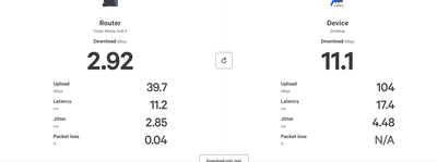

The results from Realspeed are very odd.

Check the VM Hub's Downstream tab, are there many & increasing Post RS / Uncorrected error counts.

41 Locked 28 -2.9 398181 13151540 - douglascoperJoining in
The engineer came today, replaced the hub without listening to the packet loss, and said I would get full speed in 24 hours. Now I can't even work from home.
