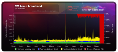

I tried to fix my packet loss issue about 3 months ago, but it never got fully resolved. Since then an attenuator has been added to fix the power levels to a normal range, but the loss is somehow even worse than it was in October. If there is a fault in my area it has not been resolved for months. Any help is greatly appreciated.
Live BQM:
https://www.thinkbroadband.com/broadband/monitoring/quality/share/a9859539a610e4fefbd92cabbe7ec26102b719d6

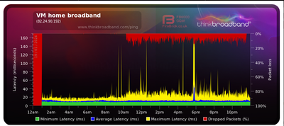

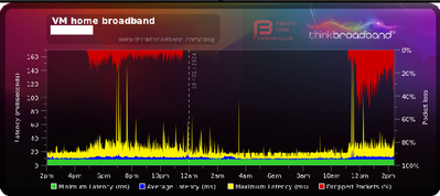

Some of the worst days:
Seems fine in the morning and then really bad at all other times.

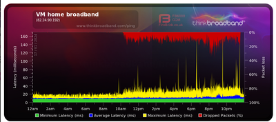

  • RM04's avatar
    RM04
    This was today its getting even worse which is ridiculous. I am seriously considering moving to a different provider unless this gets resolved quickly.
