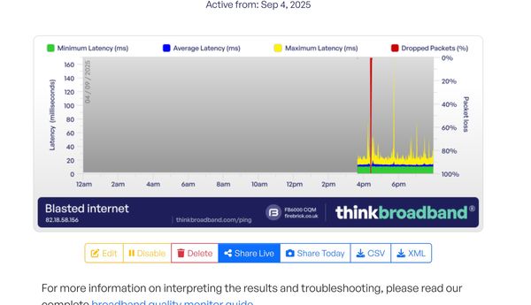

Getting fed up with my broadband
Really bad broadband, this has been going on for a while now.
This doesn't look right to me ?
5 Replies
  • Nope. Either it is pointing at the wrong IP address or you have no connection at all. Check for local faults on 0800 561 0061 and as you have had issues posted on here previously post your hub stats too.
  • You need ICMP echo set on your Hub / Router for the BQM to work.
    https://www.thinkbroadband.com/guides/broadband-quality-monitor#router
    Using a BQM is like operating an ECG machine.
    It is critical to distinguish between the patient is dead or the reading is nonsense !
  • The patient was dead it seems.
    Rebooted router and it's functioning again.
