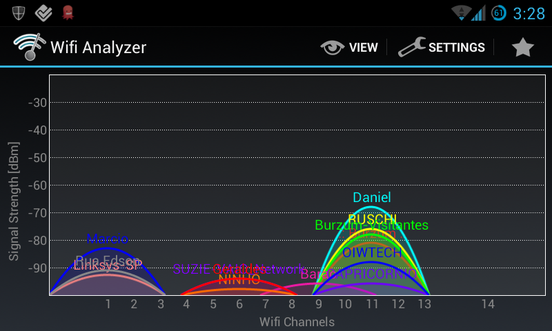

Consequently we end up with wifi channels all over the place.  802.11 works on the principle that nearby access points should be using channels 1,6 & 11, ideally with Auto-Mode for channel selection.  This way each device intelligently finds bandwidth for your data.

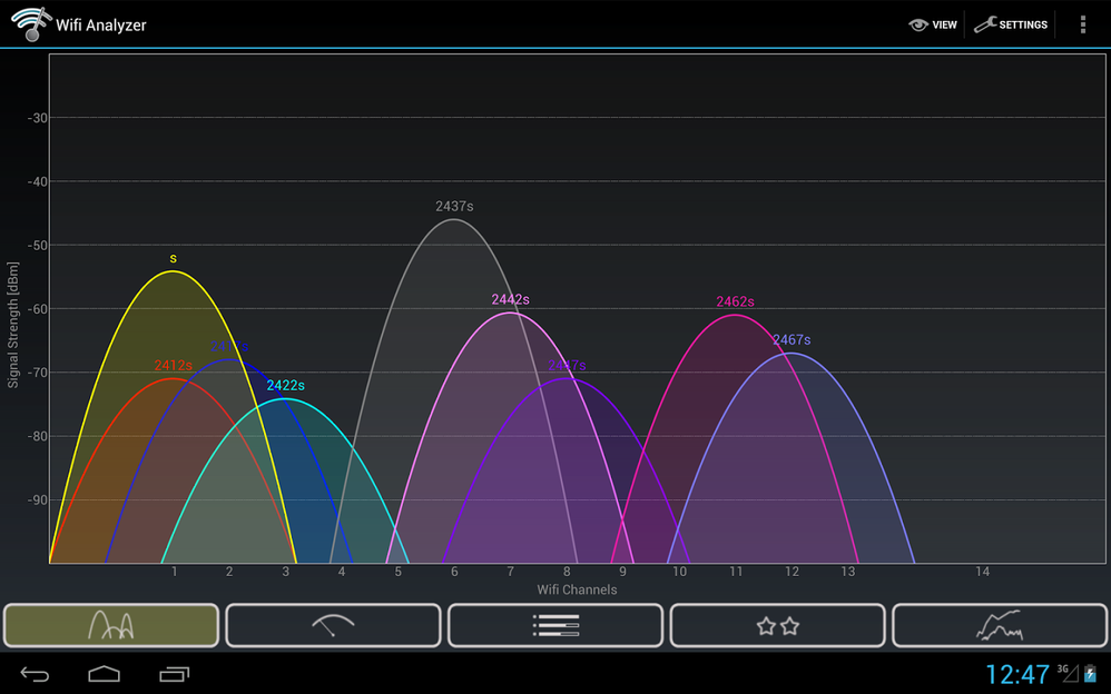

When neighbouring households start doing this, the "in between" channels get used, BUT your access point cannot see these transmissions as data, but see them as RF interference. . . . so your Wifi no longer negotiates correctly and you lose performance.
Example of Bad Wifi channel usage:
Good Wifi channel usage:
