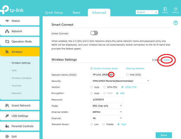

    Right so your TP-Link router is capable of 250Mb via its ethernet ports, but via its WiFi is only 100Mb?
    Log into your tp-link config page, 192.168.0.1 I believe.
    Go to the Advanced tab, then select Wireless, then Wireless Settings
    Make sure Smart Connect is disabled.
    Then Press 5GHz and try these settings.
    Security: WPA/WPA2-Personal(Recommended)
    Version: WPA2-PSK
    Encryption: AES
    Password: Your choice
    Mode: 802.11ac only
    Channel Width: 80Mhz
    Channel: 48
    Transmit Power: High
    Then make sure on your phone/computer that you are connecting to the "_5G" network.
    Let us know how it goes. Try experimenting with different channels, there are only 4 to choose from according to my emulator, 36, 40, 44, and 48.

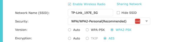

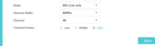

    • ttullman's avatar
      ttullman
      Thank you for the detailed instructions.
      I've followed all the steps and tried all the combinations of 40MHz/80MHz channel widths with 36/40/44/48 channels. The fastest connection that I managed to squeeze was 109MBps... :(((

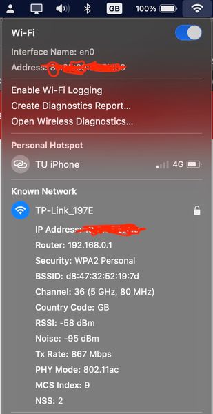

    As well as the good info from asim18 ,  The port on that Router are the older 10/100/1000 so what does the Router show in the link speed information within the Router admin pages?
    • ttullman's avatar
      ttullman
      This one is not from the Admin page, but just general macOS wifi menu
    • ttullman's avatar
      ttullman
      Struggling to find where it is in the Admin mode... Not here I presume?
