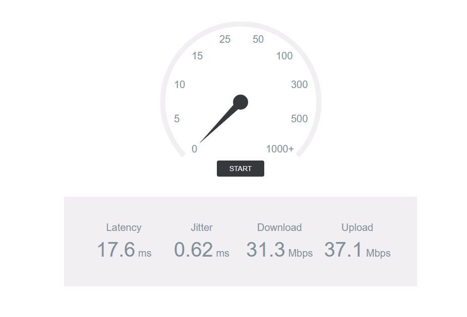

download speeds POOR!
Currently 'supposed' to be on the M350 broadband package.
The last few days, internet has been slow, almost 'crawling' along.
Repeated 'resets' of hub have made no difference to the download speeds. (currently, upload is faster than download!)
VM's 'service status' shows 'no problems' with broadband, yet, the results attached show there IS a problem.
(results are using VM's speed checker app, on a wired connection 2M from the hub)

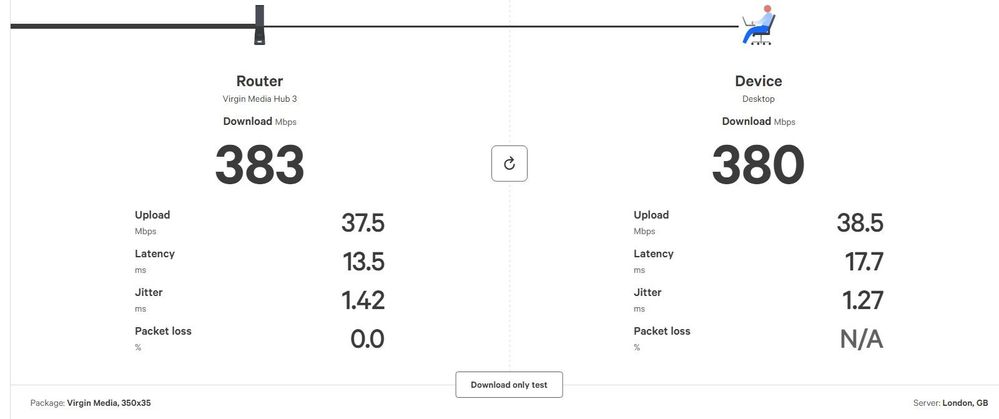

    OK, now just done the samknows test as suggested,
    Results now show correct down/up load speeds compared with the previous screenshot posted on Friday
    Hub stats still shows  poor upstream figures of 16, 16, 32, 32, 32. Non are correct at 64??
