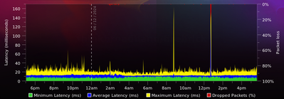

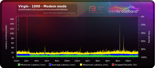

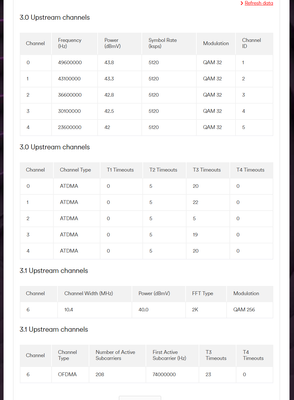

Please see my BQM, which has been running for the past 2 weeks~, as well as all power levels (although after a recent restart. There are usually more T3 timeouts on channel 0, 1 and 3)
I also noticed that before upgrading to the Hub 5, my Hub 4 used to drop the modulation on some channels to QAM 32. It doesn't happen anymore though.
BQM (please ignore the restarts)
Power levels
As you can see, I experience daily packet loss which affects gaming, however is mostly noticable in voip (zoom, discord etc.)
The fact that the connection was mostly fine for the last couple of years makes me think that there's something going on on Virgin Media's side, not sure where all that noise is coming from.

    Nothing wrong with those stats whatsoever. All I can suggest is this:

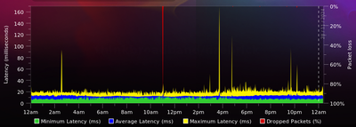

      To be honest, it does look a little bit better.
      Still packet loss throughout the day with larger lag spikes from time to time. Stats since the last restart don't look too good too.
      Looks like it completely died around 11am as well.

    I checked the stats again today and it's probably the worst I've seen yet. Lots of T3 and T2 timeouts.
    BQM shows some packet loss around 2-3am with a momentary loss of connection just before 1pm:
    Downstream on the other hand looks great:
