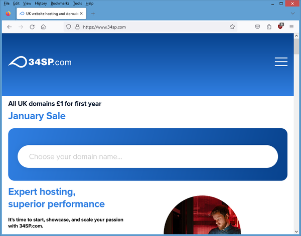

    Using our VM Connection ( from Colchester ) we can access https://www.34sp.com/
