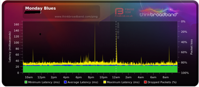

I am getting a Critical Errors - ‘No Ranging Response received - T3 time-out‘, 'DHCP renew' notice errors and a 'RCS partial Service' Warnings showing in the network log on the router. I have provided a screenshot of this and the BQM graph below. I have the VM Hub 3 which is an old router. Is there a way to export or download the network log from these routers so I can share this with you?

    The BQM graph for today should be below hopefully!! There seems to be a lot of latency.

    Currently I’m not seeing your BQM - did you make sure to edit the IP out?
  • Sorry, Yes, I edited the IP out and pasted it at the bottom of my last post about 26 mins ago. My internet connection is really flakey today, pretty much unuable!! Thanks for reminding me to edit the IP out.
