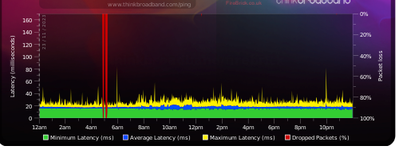

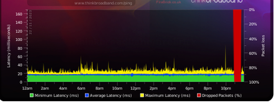

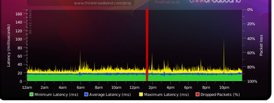

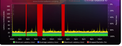

  • My issue is, is that having done a reset before an having no impact, and then you replacing the Hub 4, and am having the same issue again!  And the stuff that I have connected wired and Wireless has not changed since I had the first Hub 4 and upgraded my connection to 1GB, which had all been runging fine for 6 months without issue!  And then one week I started having to reboot my hub because the local area was 'Status Ok', a couple of times a week, and then in second week one day got really bad, only to realise you had carried out 'maintenance' in the early hours that day.  This day you then decided to send me a new Hub>
  • Lets try again, for the 19th Nov 23:
    For the 20th Nov 23:
    For the 22nd Nov 23:
    for the 23rd Nov 23:
