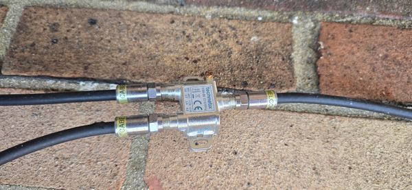

Hi
We had a Virgin broadband installation around 1 year ago, for some time now, we have been suffering from intermittent connection problems, the VM connect diagnostic app tells us there is a problem, but we have to wait 24 hours before can progress the issue to an engineer and by then it has cleared itself.
I was really unhappy with the installation engineer, he was rude, obnoxious and made a real mess.  I did report him at the time and left very negative feedback but heard nothing from Virgin.
My question is whether our cable splitter, dangling on our outside wall and exposed to rain, water and the elements is acceptable?  I am thinking that water ingress could be causing our intermittent problems.
What do people think?

    It should be protected from direct rain, either in a box or under cover. Depending on the length of cables pulling on each side, it might need physical support.

    If this is external the splitter should certainly be inside the omni box. Where do those two cables go to?

    • BlueField's avatar
      BlueField
      One goes through the wall to a Hub3 and the other one goes through the wall further up to the 360 box.
      • jpeg1's avatar
        jpeg1
        Two holes in the wall?
        There should be one cable through the wall and the splitter inside.
    I wonder where the single cable comes from?  Is it from the ground or from another VM install?
