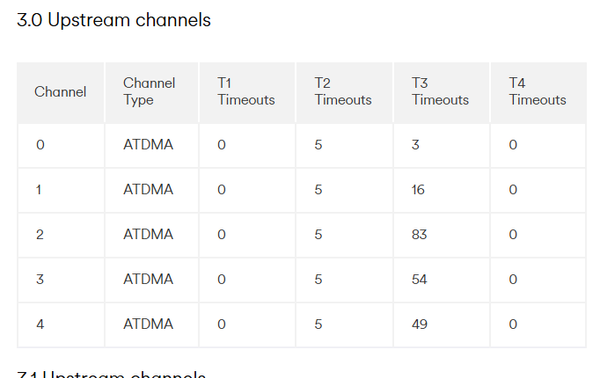

Constant drops on wired connection with the following showing on network log
23-02-2025 12:25:48    critical    Started Unicast Maintenance Ranging - No Response received - T3 time-out;[REMOVED];CM-QOS=1.1;CM-VER=3.1;
22-02-2025 21:26:53    warning    RNG-RSP CCAP Commanded Power in Excess of 6 dB Below the Value Corresponding to the Top of the DRW;[REMOVED];CM-QOS=1.1;CM-VER=3.1;
Can someone please help me understand what issue i am having. I have had 4 engineers out. Replaced the router, cables and amplifier. This is the current status. my Wifi is non existent and switching to ethernet cable my signal goes from 500mbps and drops to 1mbps and back every minute or so with the above mentioned errors and criticals
