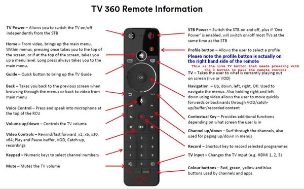

     was sent a 360 box which I connected to the point where there was a message to say the connection was successful and the remote had even been paired to my Panasonic TV. Great - except this is where it stuck! Couldn’t get connection between remote and TV. Tried to pair again - many times!
    First thing to do is check the back of the 360 remote control that is "paired" to the Panasonic TV.
    If there is a plastic tab still attached to the back of the remote as in the screenshot below then remove it -  that will allow the batteries to connect to the metal tabs in the 360 remote and hopefully get it working.
    If that plastic tab isn't here then open the back of the 360 remote and remove those batteries and try new batteries (sometimes the ones sent aren't completely new/fully charged)
    If that doesn't help then please try the following:-
    Hold  down the 'Live TV' button (the one on the right hand side directly below the red power/standby button, see screenshot below) and '0' button together for around 10/15 seconds. The Power/Standby button should then start to flash followed by an onscreen message displaying 'Pairing successful - this remote will only work with this Virgin 360 box'.
    If that fails you can also try the following:-
    Put the box into 'Pairing Mode' by pressing the Standby/On button on the right hand side front of the 360 box for 10 seconds.   Then using the remote control, press and hold the 'Live TV' button and the '0' button together for 10/15 seconds. And fingers crossed hopefully a  message should appear on the screen confirming that pairing was successful.

  • Newapollo - Thank you for responding so quickly. The tab is out of the remote as it paired successfully to the original 360 streaming box on 10 November. I’ve just tried new batteries (no difference) and also pressing the Standby/On button - which I hadn’t tried before. The remote flashes on briefly but no reaction from the box.
    I honestly have tried to re-set and re-pair this remote so many times over these 4 weeks.
  • Thank you Newapollo, Matthew_ML, Roy247 for your quick and helpful suggestions - all tried without success. However, the good news is that a brilliant engineer called Travis arrived on 16 December. After being provided with a new hub and new cables inside and outside the house we now have got Virgin TV services back - after a total of 5 weeks, many phone calls and 2 visits. Perhaps unsurprisingly- the original remote worked! Thanks again for the advice.
