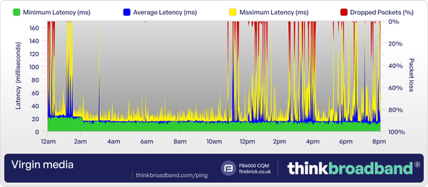

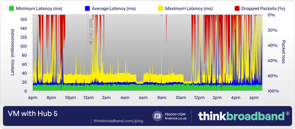

For just over a week now i have had consistant packet loss which has caused disconnects from gaming and constant time outs on discord and other voice calls.
BQM shows anywhere from about 11am - 2am the next day is an issue
https://www.thinkbroadband.com/broadband/monitoring/quality/share/3de97e68836699a3dec2ac678da9d66be21e853a
I have my Super Hub in Modem mode but did try going back to Router mode and this didnt make any difference.
Unfortunately all the help seems to suggest WiFi all the time and I run ethernet where I can.
Is there anything on my end this could be or is this something like Congestion on VM end?

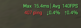

  • can see tonight on csgo several times ping jumps from 16ms to 260ms!

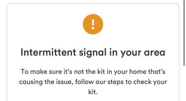

    • Carley_S's avatar
      Carley_S
      Hi Nutkin
      Sorry to hear of your concerns with your connection. We can see on the systems on our side that you have since been in touch and have steps in place already to investigate this further.
      Please let us know if you are having any further issues or have any questions at all. We'll be here to help on the Community Forums if needed.
