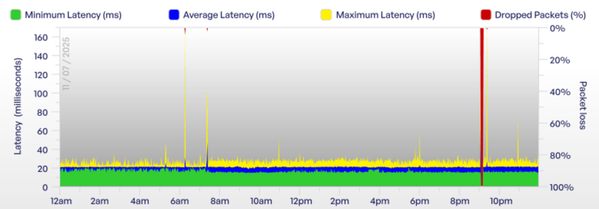

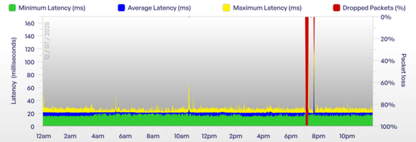

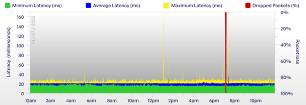

Since about the July 11th I've been suffering from packet loss, ping spikes and connection drops.
On two out of the 3 connection drops the superhub 3 displayed a red flashing light.
Please see below broadband quality monitors
11th July
12th July
13th July
Would someone mind reviewing the below stats and let me know how things are looking?
