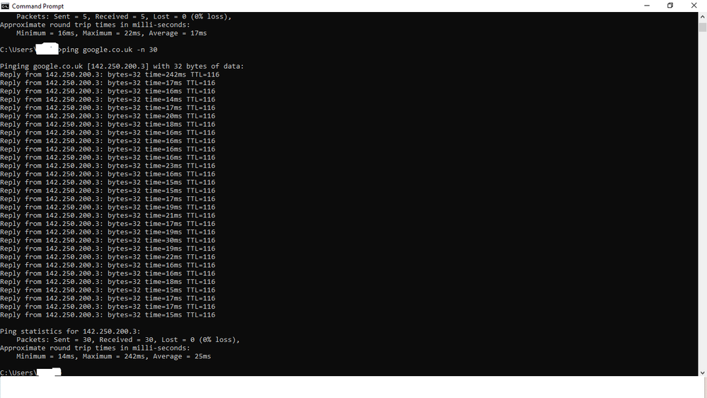

I am seeing random high pings over 200ms at random times.
I already have a 6db Attenuator on my hub 5

  • Could it be an area fault?
    It seems when my connection gets bad I notice the 10.9db appear.
    • willows2's avatar
      willows2
      i was talking to someone called vikki, they said theres an area fault but that was 2 weeks ago.
      And I havn't heard anything back yet.
    • willows2's avatar
      willows2
      NO. It says no issues found.
      But i did get a text message from virgin saying there was an issue, they never told me they fixed it. I am still waiting on vikki to let me know if its been fixed its been two weeks now.

  • legacy1's avatar
    legacy1
    likely upstream utilisation hit high in your area
  • engineer visit, he wasn't able to fix the fault. I still believe the fault is external.
    He put two attenuators on the back of my hub to try and bring the levels down it only  helped a bit.
