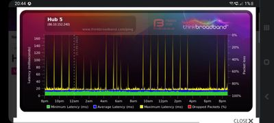

Broadband Status
Below are my Hub 5 Stats.....lots of Pre RS Errors....what could be causing it ?

    Well .....
    After complaining to VM for months and telling them it was the Hub 5 or the Cables, finally an Engineer came.
    He was one that had come previously, but not been able to diagnose the fault.
    He tested the cables all the way back to the Street Cabinet.....all was well
    Unsure of what to.do, I suggested he replace the Hub 5
    Bingo.....problem solved

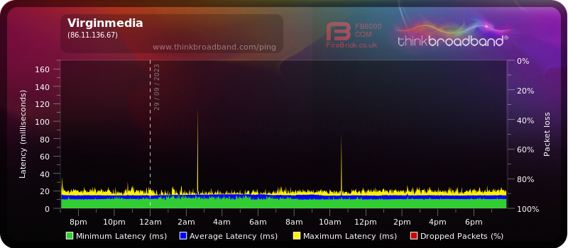

  • javedsaleem's avatar
    javedsaleem
    Below is a pic of the BQM, AFTER  the Hub 5 was changed, at my insistence

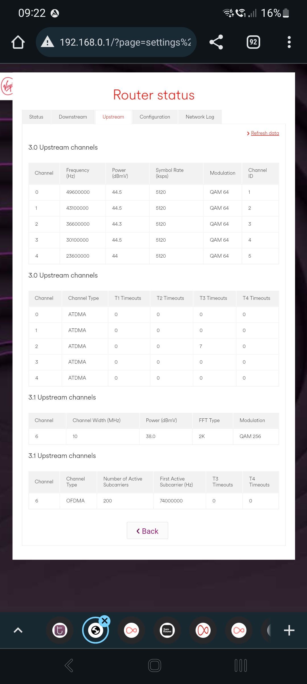

      javedsaleem
      The router status page has changed.....it's now shows 3.1 upstream channels
      Can someone explain what has changed ?
