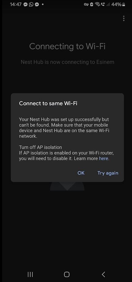

Can't connect Google Home devices to Hub 3
I have been having nightmares trying to connect Google Home devices to my wi-fi. At first, I assumed it was related to my Deco mesh network but I have tried creating a test Google home using the wi-fi from the Hub 3. I get the same turn off AP Isolation error. AFAIK, there is no such option on a Hub 3.
Weirdly, my first device, a Google Audio speaker, connected seamlessly. The next device, a Google Mini, needed a few resets/reboots before it connected and then adding a Home Hub display seemed to fail every time.  However, I left it and came back later to discover it had magically connected. After having to try to reinstall it, I haven't been able to connect it again. Same issue with a second Google Audio received today. At the final 'connecting to wifi' stage, I get the AP Isolation error below.

    There is no reason why the VM Hub can not offer SSID "Esinem" making it an additional Wi-Fi access point.
    If the SSID VM5506638 is visible the Hub 3 is in Router mode,
    to avoid double NAT issues, that means the Deco should be in Access Point mode.
    The mobile VPN must be disabled to access devices on the LAN  / Wi-Fi network.

    I did try with and without NordVPN.
    I have no idea what solved this but after trying various things including removing all my Google devices, I was able to re-add them without the error and set personalisation on with the Home Hub.

        Thanks. The Deco mesh creates a separate network. The main Deco unit is hard wired to the router. I have no clue what mode the modem is in. Everything runs off SSID Esinem and I ignore VM5506638. If there's a better way to do it, I'm all ears so long as I don't have to reset everything using the Esinem network.
        The problem of Google Home devices not connecting disappeared after various reboots and resets. Still no idea what caused it.
    Hub 3 does not have AP Isolation enabled.
    There is a key icon on the top line of the phone. Does that mean the phone is using a VPN or Apple Relay or an Android DNS changer ? Any one of these would mean your phone behaves as if it is not on the local Wi-Fi of the VM Hub, that could easily be mistaken for Wi-Fi AP Isolation because the app would not find the Google device.

    Sound like your wifi has a single SSID for both wifi bands.  If the Google kit is joining the 2.4 Ghz band and your phone is on the 5Ghz band that may be why it's not working.  Also you should make sure your Deco SSID matches the SSID and passwords set on the Hub.  Otherwise you end up with two competing wifi signals.
