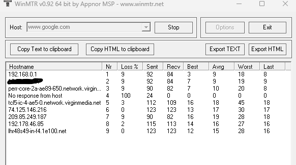

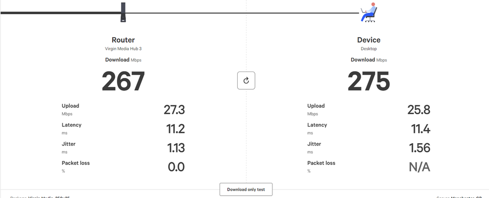

    • Wimc99's avatar
      Wimc99
      Hi - SS below, interestingly on Samknows it shows as OK, but on WinMTR (which is what I usually use) it shows 9% (It's actually up to 12% now)
