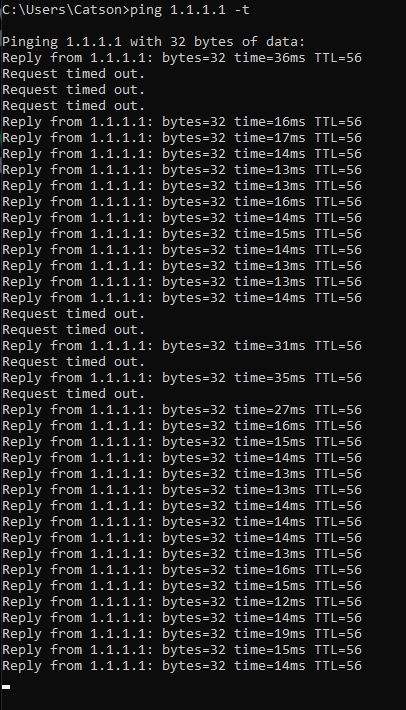

    There are problems with VM since yesterday. And not only for me.
    Intermittent connection.
    Dropping for few secs few times a minute.
