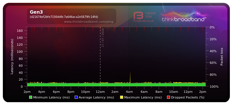

I have the symmetrical Gig2 service. Over the past few weeks, I have been experiencing periodic packet drops every hour, specifically around 12 minutes past the hour. Despite having the Hub 5x in router mode, this issue persists.
Upon investigation, I noticed that I can replicate these packet drops when I run a samknows/realspeed test. It appears that realspeed is running a test against my line at these intervals. Strangely, when I initiate a download of approximately 20Mbps, the dropout does not occur.

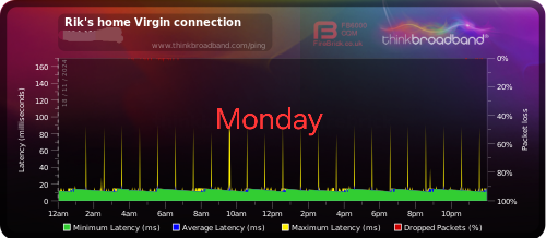

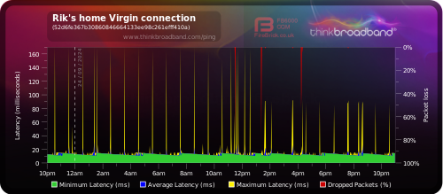

I have tested this behavior across different devices, both via Ethernet and Wi-Fi connections. Additionally, I have set up a BQM, which clearly shows the regular drops. The absence of drops during the 20Mbps downloads further supports my suspicion that realspeed testing is causing the issue. How do I get realspeed to stop running tests against my line every hour, as it disrupts the service.

      Today, I get a reply saying they've been testing the router with Samknows and don't see any faults!! I tried to explain that you can't use samknows to test itself, because the problem occurs DURING the test. (cries a little inside).

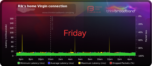

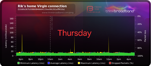

      I've shown them this: https://itty.win/gen3 dozens of times, but they dismiss it and say "our samknows tests don't show any packet loss".. There are parts of the graph that (depending on when you view it, as it's live) are clean , those are when I start a 2MB download in the background (using Steam set to 2MB limit, lazy I know lol). If my network is downloading anything above 2MB doesn't kick in, but anything below that and the realspeed kicks in every hour and I get packet loss which affects my voip calls, my gaming sessions and kicks me off my charity streams.

      They said they've tested the router with samknows and don't see any issues. I mentioned that you can't test samknows issues with itself. I even sent them my BQM graph. You can clearly see, again, the hourly packet loss.
      The two spikes at the start of the graph, are the auto test and one they ran manually (they ran a test and it showed up as a clear 10% packet loss spike, but that's not enough apparently). The gap where there's no packet loss, is where I set a 2MB download via Steam (download a game and set the download limit to 2MB, lazy I know). Where I was able to stream, and use voip. The minute I closed Steam, the hourly packet loss started again. Which mean, packet loss during my voip sessions, lag during CoD (haha, first world problems) and my charity stream got disconnected.

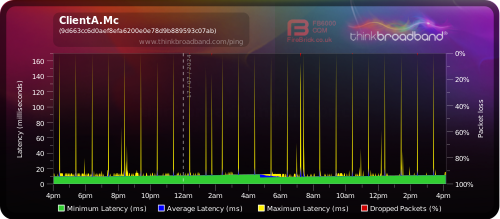

      I set up the same BQM for one of my clients who also has recently joined virginmedia full fibre, a few streets down from me. I think they're on half gig. They have no idea what's causing the regular lag spikes, which are happening even with nothing connected to the hub. Coincidence?

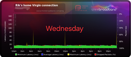

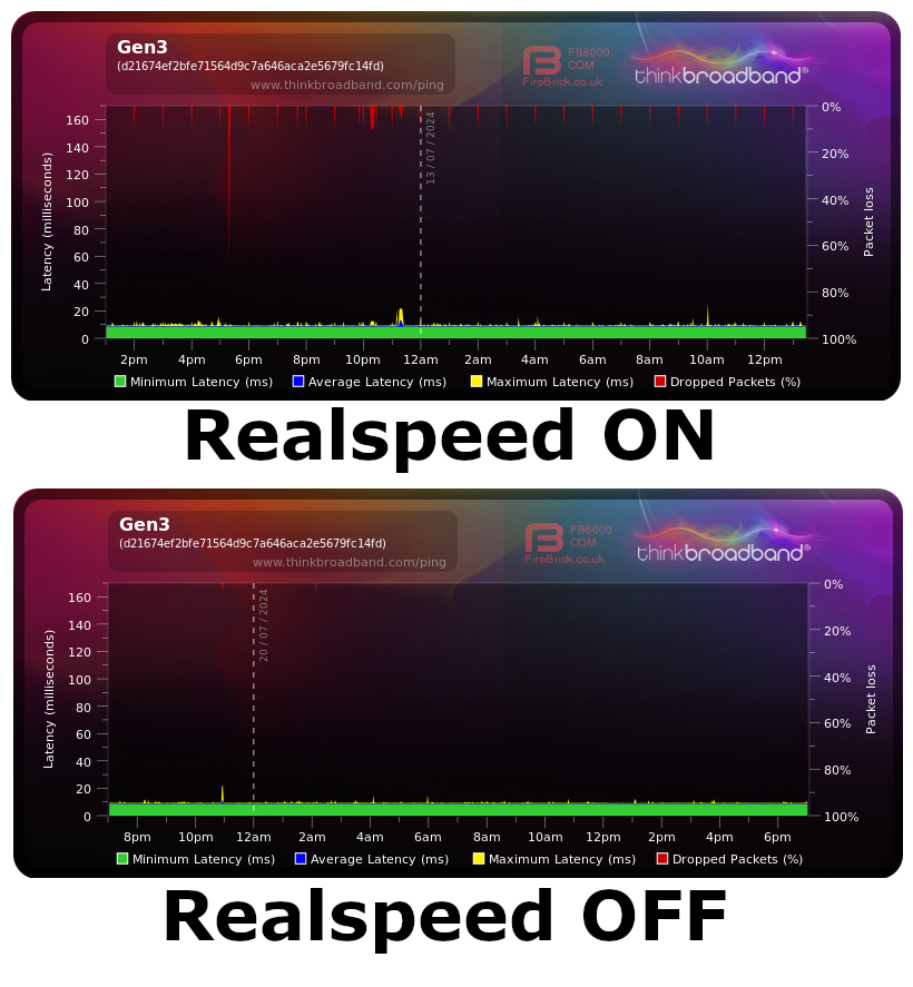

  • Just wanted to give an update. If you're having the same issue as me, maybe you can convince them to turn off realspeed to see if it clears up the packet loss issues. I obviously don't expect a new service to go without teething problems, and I had a couple of packet loss events even with realspeed turned off, but it's clearly an improvement.

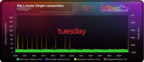

  • Has anyone else noticed they no longer get the hourly ping spikes? Mine stopped on Tuesday
  • no mine are still ongoing and have been for months, even after raising a support call that went down a black hole at Virgin.  They know what causes yet refuse to do anything about it and act dumb.  Luckily I have two fibre providers I use at home, but is painful that I have to pay for a Virgin connection that I can't use for work as nearly every hour i get vpn drops or Zoom/Temas meeting issues because of this.  Can't wait to get rid of Virgin for internet they are absolutely hopeless.
