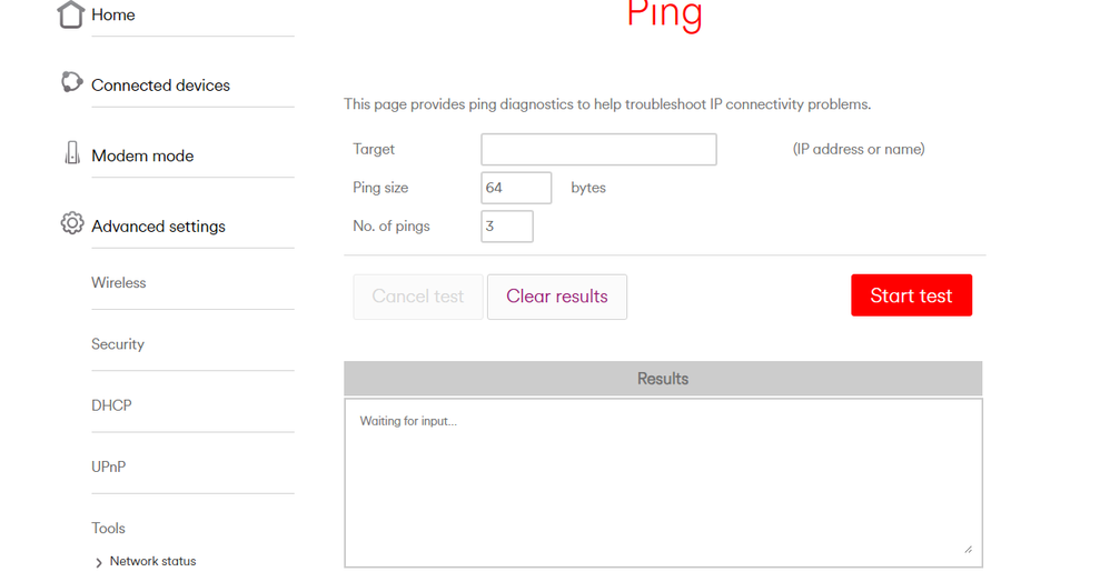

    Hi thanks for the instructions however I followed the tabs and can't see a respond to ICMP echo requests sent to WAN IP tick box option anywhere.
    Here's a screen shot of what I see when I login:
    Oh and its showing 100% packet loss yet again!

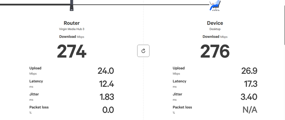

    I've stopped the BQM now. I'm only looking out for packet loss really as my work involves video calls often so I need my upload speed to be working properly. I had issues a couple of years with power spikes and SNR issues but an engineer installed an attenuator which seems to have calmed it down.
    I ran a full test on the link you gave me, here's the results.
    For M250 the Realspeed figures are as expected and no packet loss.
