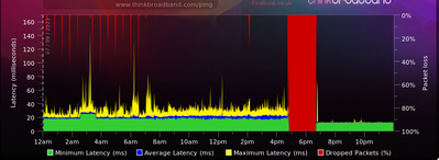

  • So here is my final post on the matter. I couldn't live with it any more and had Vodafone / CityFibre FTTP installed yesterday. You can see the ICMP trace since it was switched on (the big red bar is when I had forgotten to update the IP address):
    I'm not saying that this has definitely fixed it but I just had a 90 minute call this morning where there was zero jitter or problems with people hearing me on it... I haven't had a call like that on Virgin for probably 6 months at least, possible more.
    Sorry to say I think this was an issue with Virgin Media and not my equipment. My best guess is that there was too high a level of noise on the upstream and it became marginal when we were moved up to 100Mbit. We will never know because an engineer was never sent to the house in the 4 or 5 months that we had issues. Honestly, I don't really care - I'm just glad my wife and I will no longer be getting drop outs during calls when we work from home. Thanks to the helpers on this forum for trying to get it resolved. If I was to give one piece of feedback to Virgin Media - you should definitely fix the SNR being broken on the Hub 4... its like trying to diagnose issues with one hand tied behind your back.
