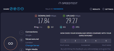

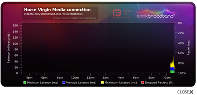

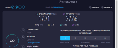

        My apologies for the delay, I was away. I have created a BQM today, using the default settings it suggested, and it has a bit of information.
        I have changed the WiFi channels as recommended, and I took the tests from both thinkbroadband and Ookla (see below) via my desktop PC over WiFi.
        Thinkbroadband – Could not see an option for 1x or 6x.
        Ookla
        Multi
        Single
        Also, after the tests above, I turned on my PS5 (connected via ethernet) to download something and it was doing it at 95mbps, which is nowhere near 1GB.
        Any ideas or suggestions? As always, thank you very much for your help!!

    You seem to be rate limited going by the high download latency.
    The router you have has a QoS which is set to Get via Internet Speed Test which is never a good idea try it to manually and reboot if needed.
