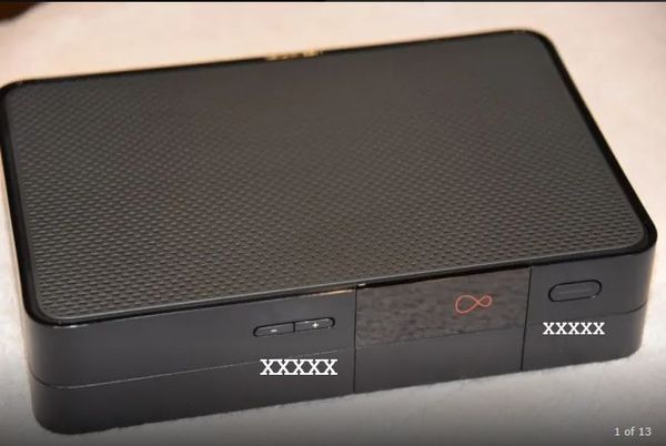

    Providing you also have the new 360 remote control then if  the above still doesn't work then you might be able to force the over the air download  by performing the following:-
    You could try turning off the V6 by the switch on the back of the box;  then on the front of the V6 box  hold down both the standby/power button and the - button at the same time. Then turn on the V6 again whilst keeping hold of those buttons for a further 30 seconds.
    If the standby/power button and the -  button workaround doesn't solve it then try using the standby/power button and the + button at the same time instead.

      Power+ [-] showed a "downloading" icon for a while, and finally booted to the same situation as before.
      Power + [+] went through a software installation screen and then a V6 software update screen, and then back to the same situation as before.
