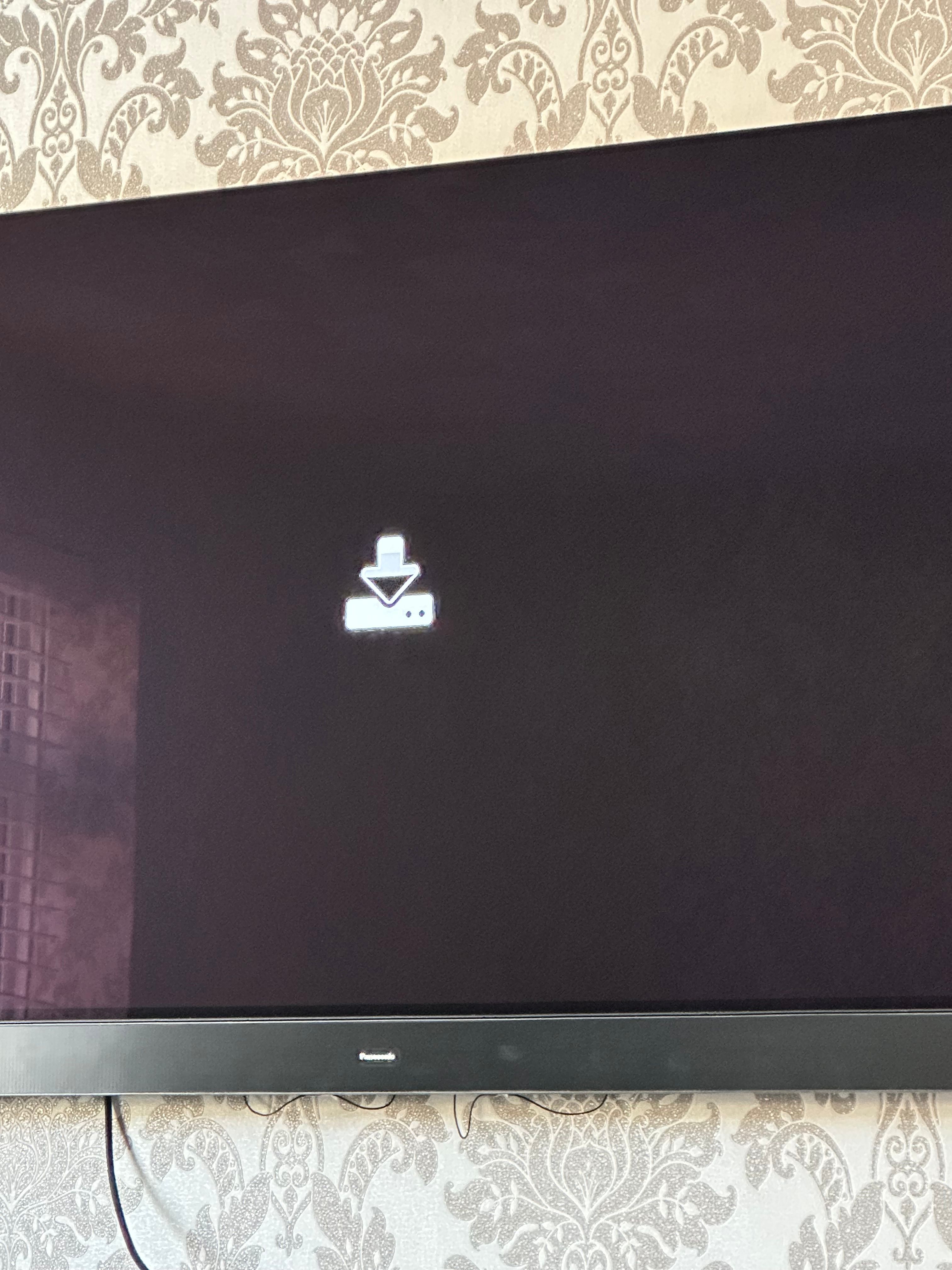

That looks like a TV software update rather than a virgin media box
- roy247Hero
If it's still doing the update you should be able to prove if it's the TV or 360 by selecting a different HDMI input on your TV by using your TV's remote, if the screen stays the same then it looks like it's the TV possibly stuck doing an update, if that's the case then you will probably have to power the TV off and on and hope it's OK. 🤞
- newapolloVery Insightful Person
Aside from rebooting the 360, how is it connected to your hub? If possible connect it to the hub with an ethernet cable and reboot to see if a new internet connection pushes the update through.
You can also try the following, which has worked for some forum members.
Turn off the 360 at the switch; then on the 360 box hold down both the power button and the + button at the same time. Then turn on the 360 again whilst keeping hold of those buttons for a further 30 seconds.
The box should reboot, the power button will turn blue, and it should reset and either download the update or boot up normal.
If that fails then you should contact faults 150 from a Virgin landline or 0345 454 1111, option 2 (Faults)
When calling Faults ignore all the options and don't press any buttons then you should be placed into a queue and an agent should pick up the phone and book the tech for you.
Or wait a day or two and a member of the Forum Team should pick this up for you

- jfroggyJoining in
It’s not the tv as swapped the one in the bedroom to the main tv. but the 360 box needs replacing, a new one is on its way, not sure when as the text from yodel said it be delivered on Saturday but still not arrived. But thanks for your replies

- andyjm1983Tuning in
I had same problem and had to factory reset the box by pressing 2 buttons on the box together
