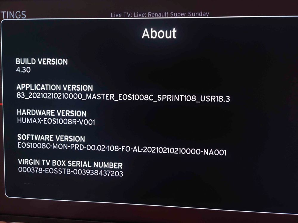

My box details are below, and here you will find a video (link is to OneDrive) where you can hear it happening twice in less than 25 seconds: https://1drv.ms/v/s!AnpNCXerIeQkiJF30zrMfF5-1tN3RA?e=1F3oSK

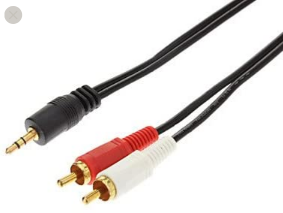

Take the audio feed from the 3.5mm socket at the back of the 360 box using a 3.5mm to RCA lead as shown in the image below - No sound dropout or sync issues and it will carry a Dolby audio signal.

Colin,
Many thanks for the suggestion, much appreciated and glad it sorted your issue. I have updated settings and will listen out to see if it resolves my issue this evening.
