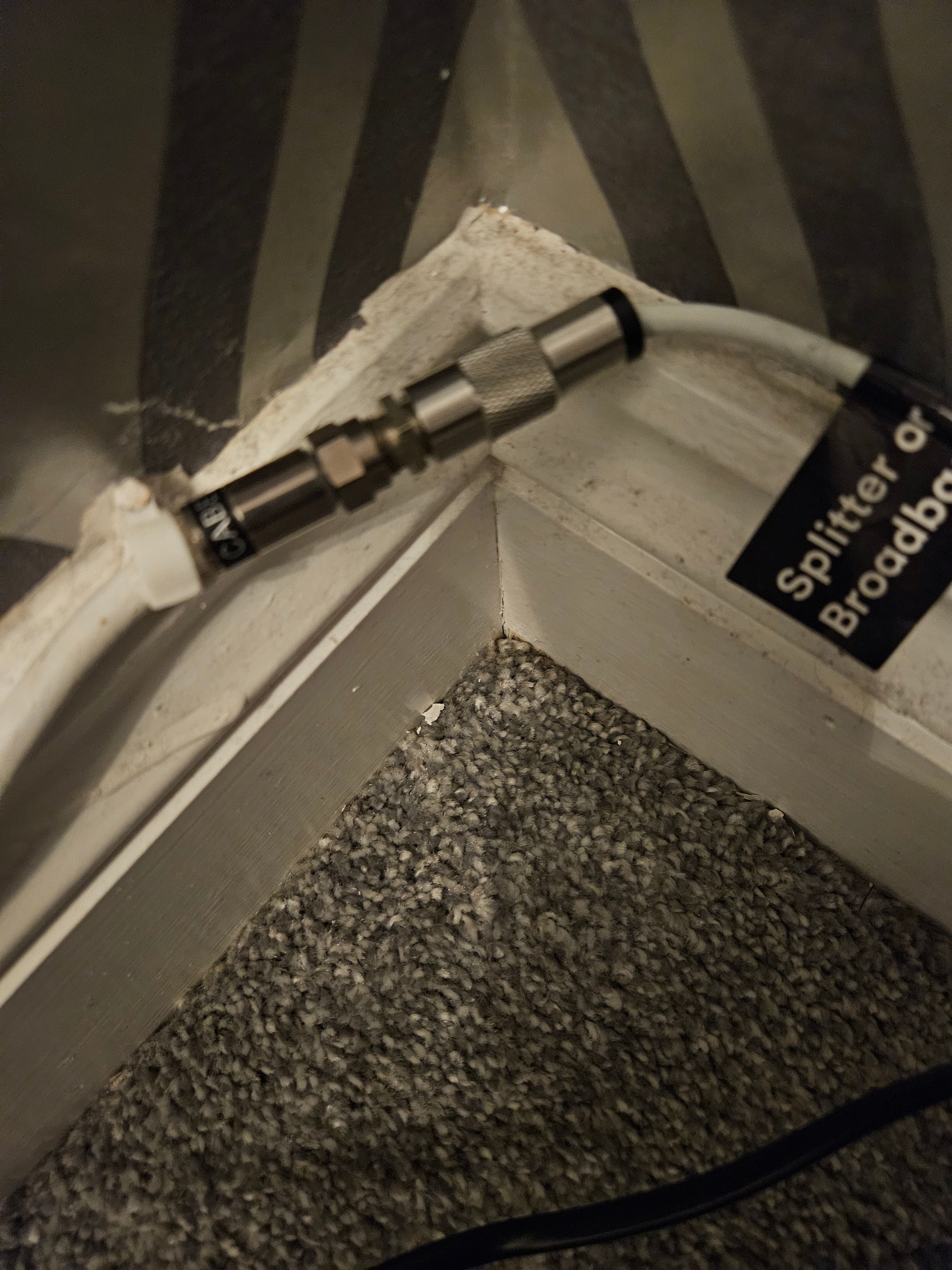

      Hi Sabrina,
      Thank you for your reply, it is becoming unbearable now can happen 3-4 times 30 minutes, I have a Samsung TV, it does not do it with any other device such as games console etc I have also tried all Hdmi ports and new cables with no luck, it never did this with SKY Q
      Additionally i have restarted the box and router, and checked for updates.
      I believe its the box and it doesn't help the one I was supplied was clearly 2nd hand.
      I read your messages on:
      https://community.virginmedia.com/t5/Virgin-TV-360/Flickering-black-screen/td-p/5460575
      And note the wiring done inside my property by your engineer is a bit of a cowboy Job, between the wall and my v360 box the is 4 joins. These cant help signal quality. One of which they have just pushed the self install kit onto a threaded connector
      • Beth_G's avatar
        Beth_G
        Hi KHarris85
        Thanks for coming back to us and for sharing the picture of the wiring. I think it might be best if we arrange for an engineer to visit and take a look.
        I've dropped you a PM so I can ask for the account details 😊
