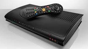

  • Which TiVo box are you replacing the old TiVo box or a V6 TiVo box, if it's an old TiVo box it will need a separate connection to your hub, the old TiVo box had an inbuilt modem. Pictures below of the 360 main and mini box and the old TiVo box. If you have replaced a V6 TiVo box that looks the same as a 360 main box but with different remotes and software.
