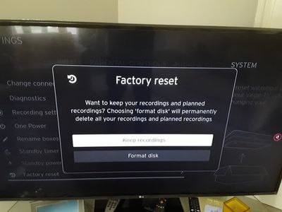

    I reset the box using the system menu, opting to retain all recordings. I've done this a couple of times. In addition, we use the high contrast display and that restarts the box when selected (why it can't just change I don't know, even MS Windows changes the display without restarting, as does every mobile phone for at least 10 years).

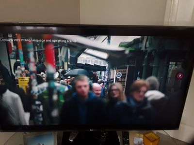

    The menu buttons are at the top. You can see the highlighted play button. That's as high as it will go. This is the first page, immediately after Netflix opens.

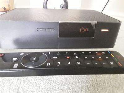

    This is the box 360 yes?

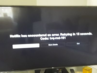

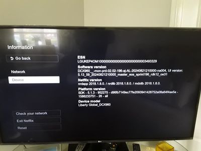

    I've found if I press the back button several times, the Netflix app crashes and display this error. I can't find that error on the Netflix site. Tvq-rnd-101 (the closest code ends 100 which signifies connection problems.

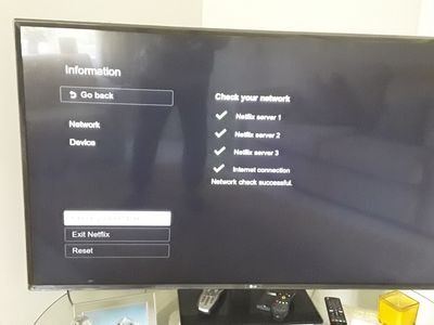

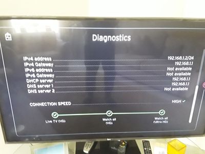

    But that page allows access to this page which shows there is no network problem.
    Page 2. Doesn't mean anything to me, but maybe someone else? I haven't tried the reset button because it might lose all the lists we've saved and maybe the profiles also.
    Virgin diagnostics also show no network problems.

    Not really much use but this is the opening scenes of the programme being pushed on IPlayer Showtrial.

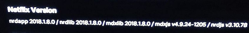

      I did notice however that the text in the app alongside Netflix Version is slightly different in format on mine compared to the one in your screenshot which might explain the differences we are seeing.
      Mine has additional information at the end, 'mdxjs v4.9-1205/nrdjs v3.10.78 ' which might explain why the menu position has changed. (pictures below)

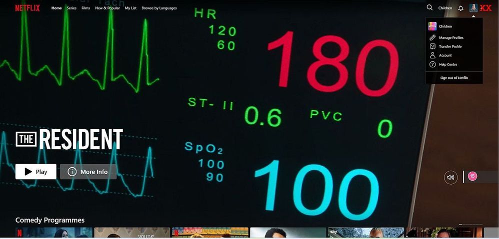

      Your Netflix home screen looks like this which you might see if you accessed Netflix using your TV's app.
      I have the same version as newapollo apart from 79 instead of 78 at the end and my menu is still on the left.
      It does say in the article " The company told The Verge that users will be able to access the top menu by either scrolling to the top, or hitting the back button on their remote."
      Probably won't work on the 360.
