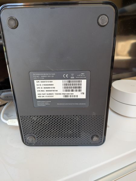

    • Shaunmumford's avatar
      Shaunmumford
      This is the box. Doesn't have any identification other than the label on the bottom. I understood this to be a V6 box but happy to be corrected, not my area of expertise.

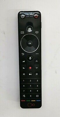

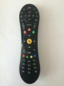

      OK, this is a case of not understanding the question. The Arris manufactured box you have was originally despatched with TiVO firmware, which in combination makes it a V6 box. If you have since migrated it to 360 via invitation or contract change, the TiVO firmware is then replaced with Horizon firmware & a new remote, at which point it becomes a V360 box.
      So what is different is the remote:
      TiVO
      Horizon
      Which one please?
        Shaunmumford
        Ok, I bow to your superior knowledge. We have the second remote you title as Horizon.
