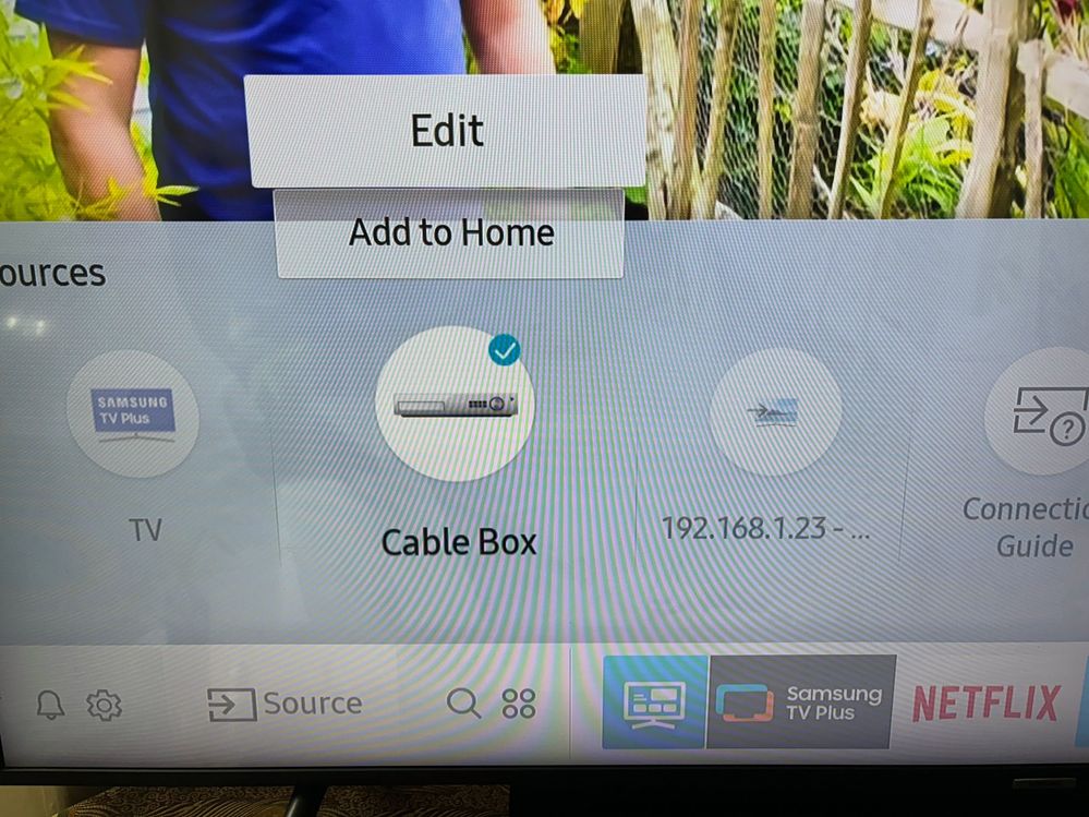

  • If it's a Samsung TV, press the 'Home' button, press left arrow 3 times to get to 'Source'. Arrow up to HDMI then up again to edit. Change 'HDMI' to 'Cable Box' and then the TV won't keep the HDMI port on when the Virgin Box turns off ðŸ™‚
