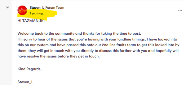

Wrong Time on Handset since moving to Digital Voice
Since moving to digital voice 2 weeks ago when we set the correct time on the BT digital handset when a call comes in it sets the handset phone 1 hour in front.
When you change it back and get another call it reverts back to 1 hour in front again their is a issue with your CLI information that needs sorting.

      Hey ozsat, thank you for reaching  out and we are sorry to hear about this.
      We are aware of this and it has been passed onto the relevant team as mentioned in your screenshot the team are looking into this.

      • Steven_L's avatar
        Steven_L
        Thanks for coming back to us Thomasba and we apologise if you've been told that your handset was at fault for this. Our teams are looking into resolving the issues going forward.
