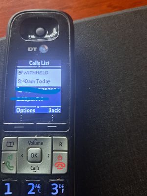

  • Hi does this work on call guardian phones as we have a issue with withheld number comming throung but throght it was a issue as the shows as caps letter not lower case like normal
