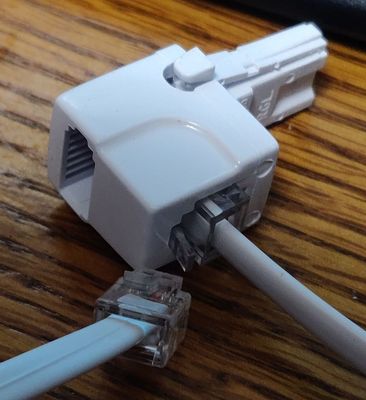

    The phone will plug into the TEL1 socket on the back of the hub. It does not use ethernet to connect the phone. VM provides you with an adapter to plug in an ordinary telephone into TEL1.
    The most simple solution, with least disruption but at a cost to you, is to buy a cordless phone system (two handsets or more). Plug the base station into the phone socket on the VM hub with its accompanying handset next to the hub and use the second satellite handset at your chosen location. If you want more handset locations add in more satellite handsets.
    VM will offer to move your hub but that may have other implications such as changing the wireless coverage in your home or preventing wired devices from being plugged into the hub if it moves elsewhere.
    VM should also offer to modify your existing telephone sockets so that they can be linked to the phone socket on the hub. This will, however, involve some wiring disruption. It will be least problematic if you happen to already have an existing telephone socket next to the current hub position.
    Unfortunately, if you are in the habit of turning the hub off, you won't receive any landline calls while the hub is off in the new arrangement.

    You must already have a coax cable coming in from outside to connect the hub.
    Tudor is suggesting that you get VM to install a telephone socket next to the hub and then run a phone cable which follows the same path as the coax out to the omnibox on your outside wall.
    The new phone cable is then linked inside the omnibox to the existing phone wiring and your existing telephone wall sockets can then be made live as described below.
    Past topics have shown VM can do this by using a cable from the TEL1 socket on the VM hub to back-feed a connection into an adjacent telephone socket.
    Example below
    You would have to add another phone cable but it would follow the path of the existing coax.
