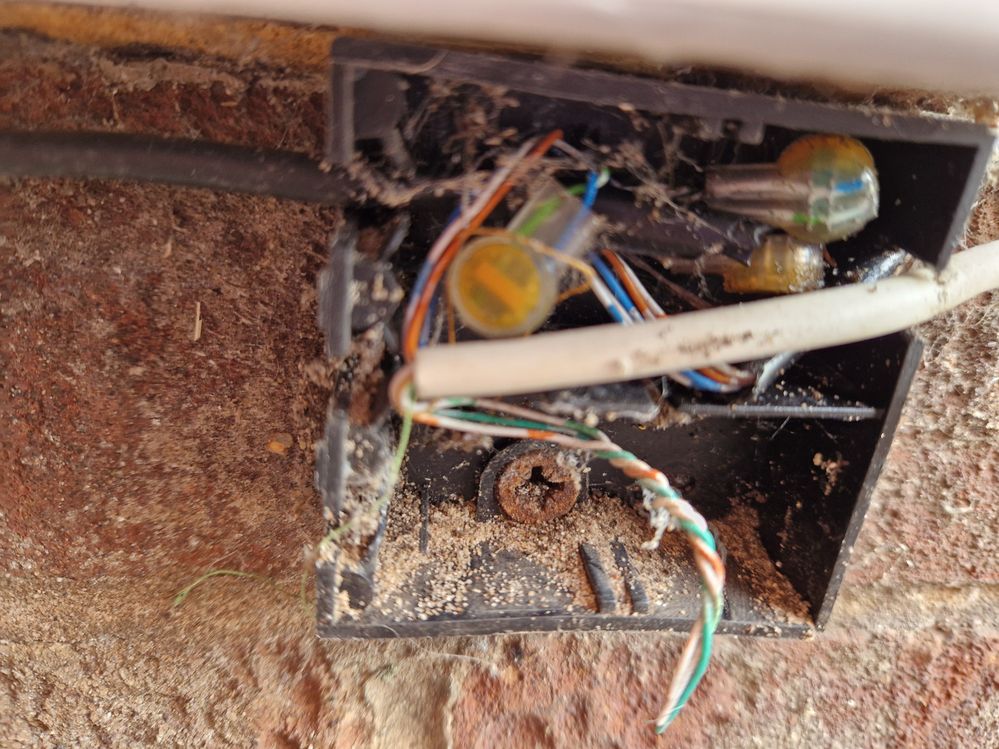

The problem is that the installation is not as simple as nodgrogd describes. Virgin broke into an existing extension cable to provide a feed to a socket close to my desktop. As you will see from the photo below, it is not simply a matter of unscrewing the unwanted cable. This box is under the doorstep of my backdoor and at 79 the prospect of lying on the drive and working out how to separate the unwanted cable from the feed to a socket I want to keep does not appeal. £25 to solve my problem seems fair to me and I would just like some help in arranging an appointment for Virgin to do the work. Thanks in anticipation.

Well it turned out that the problem was more complicated than I realised. Whoever installed the latest extension (and it might have pre-dated Virgin) used the return feed from the kitchen extension to power the new one so just cutting the cable wouldn't work. The Virgin technician was brilliant and my landline is now VOIP and the cable to the kitchen is dead. I'm extremely grateful for the help I received both from Daniel and Virgin's technician.
