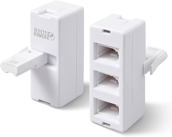

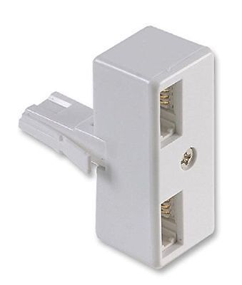

    Note on a VM Hub the Tel 1 port is the only one that works.
    Use Hub port Tel 1 with the VM supplied RJ11 to BT socket adaptor cable,
    and then add BT double or triple socket adaptor.
    Now the telephone + building alarm can both be connected at the same time.
