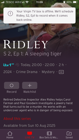

Another with TV Go app not able to set remote recording
TV Go app won’t set recordings remotely whether 360 Box is on or off.
Standby I power is on Active start. Get message that Box 360 is offline and will schedule recording when next turned on
anyone able to suggest what to do to rectify this, please?

      Hi MumD thanks for your reply here.
      Are you able to provide a screenshot of any errors for example of what error you receive?
      Many thanks

      Yes both wifi and mobile data. Yes, everytime
    • MumD's avatar
      MumD
      Settling in
      I Cannot remote record whether on home wi-fi network or mobile data.
