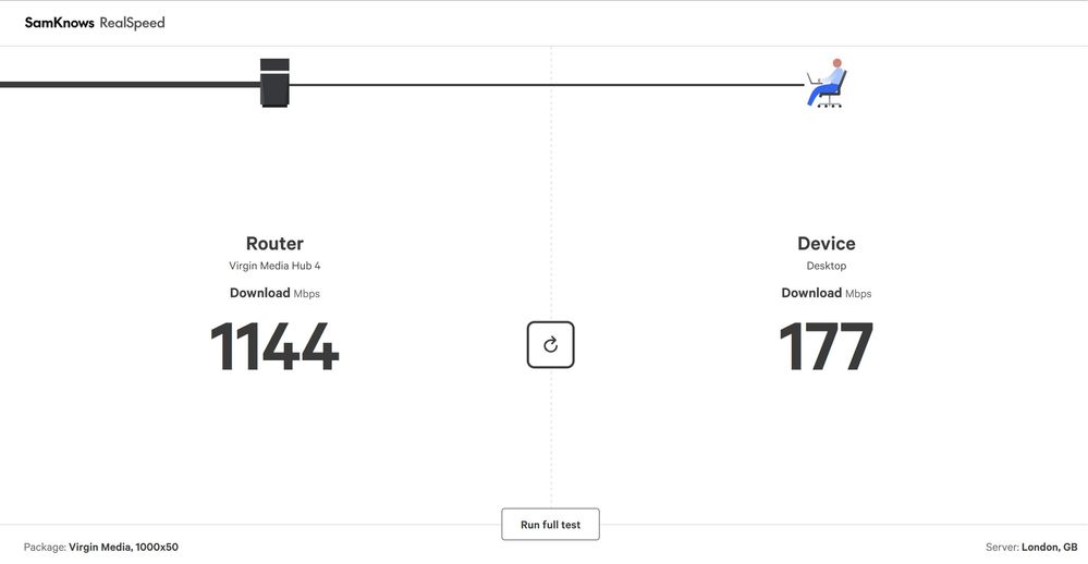

  • Out of curiosity I decided to test the speeds directly from the Hub 4.
    I disconnected the Orbi mesh router and reset the Hub 4.
    I connected my Windows 11 laptop directly into the hub using a 1Gbps ethernet/USB c adapter with a Cat 8 cable.
    I ran the Samknows RealSpeed test and got the following results:
    Again the wired connection is much slower than wifi.
    Wi-FiWired
    Do you guys think there is something amiss here?
