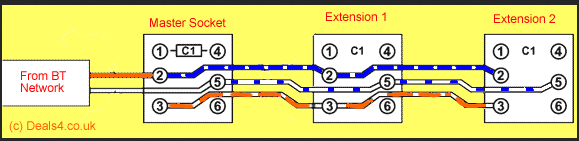

  • One would first disconnect the exchange line at the master socket - take care as it may still have 48 volts DC enabled.
    Then connect the centre pair of the RJ11 from the Hub to contacts 2 and 5 of any telephone socket.
    ( or one could use a long modem cable )
    Home phone sockets are wired like this ...
