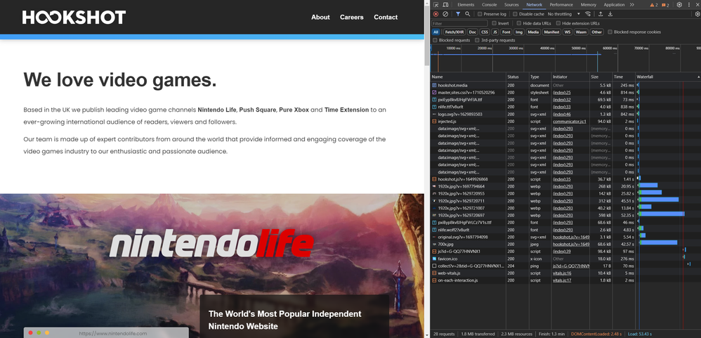

Hi all,
This week I have had FTTP Virgin Media 500M installed, through SpeedTest.net I'm getting results of 550mbit down & 54mbit up -- great (via ethernet).
However, I've noticed some major lag when visiting my work websites. They are all public-facing and use the cache/proxy of Cloudflare CDN.
If I hard refresh (no cache) view https://hookshot.media with a naked VM connection, the page + assets can take over 1 minute to complete all the requests. Which I have never seen before on any other ISP.
Virgin MediaIf I do the same test, connected via NordVPN, it takes around 0.3s:
VPN
Does anyone know what is going on here? Does Virgin Media have known routing issues with Cloudflare?
Any help would be appreciated.
Cheers

      I just tried disabling the Cloudflare proxy on the website, and requests going direct to the origin server are <1 second.
      It appears it's some routing issue between Cloudflare's CDN/Cache and Virgin Media.
