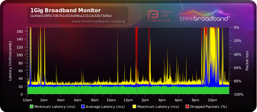

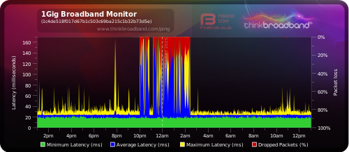

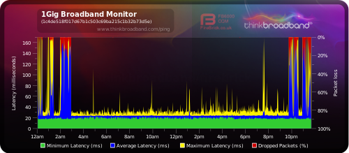

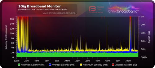

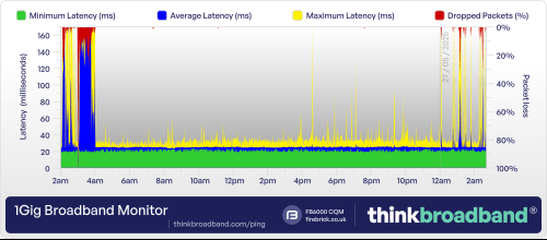

I have an issue with my connection which i have been monitoring for the last week with the Think Broadband Quality Monitor.
As you can see, that just before 10pm every single night until after 2am, i cannot play any online games, let alone watch Netflix, Disney or Amazon as it just constantly buffers.
There is obviously someone or something that is causing this traffic at that time and it is rendering my connection useless.

This is the 26th April 2025
This is the 27th April 2025
This is the 28th April 2025
This is the 29th April 2025 (Todays so far)

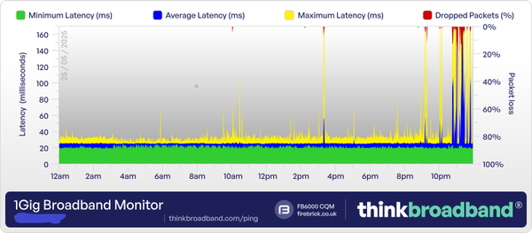

    This is updated Hub 5 details.  And Also decided to put just one Think Broadband Monitor on.
    It is impossible to online game as the lag is awful at night and i keep getting disconnected.
