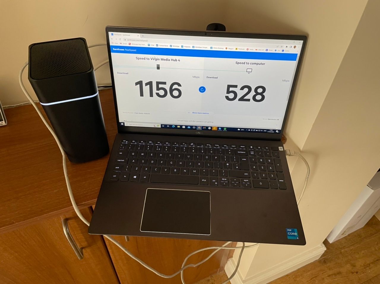

    I am also having a similar problem to this. I have recently joined Virgin Media and have the 1GB broadband service (1000x50). When I run the SamKnows speed test (on WiFi or Ethernet) I receive around 1154Mbps Download to the Virgin Media Hub 4; but only around 500Mbps to the device. An example device is my Apple iPhone 12 Pro; but I have also tested with a year old Dell i5 laptop too.
    The strange thing is my Dad has the slower speed connection at his house (600x40), and when I did the SamKnows speed test on the same device there (on my iPhone 12 pro) I was getting 649Mbps Download to the Hub (he has a Hub 5, but previously had a Hub 3) and 645Mbps to the device. Therefore I'm getting a higher download speed but on the lower tariff.
    I have tried to keep my testing the same (e.g. similar distances to the router), both were done at night last night.
    I have tried to check/work through some of the other suggestions on some of the posts, but I couldn't see anything obviously wrong in the config. Does anybody have any advice to increase/resolve this?
    Cheers
    Jamie

      Hi there jamierawlings, welcome to our forum and thanks for your post.
      I'm sorry to see you are not seeing the expected speeds to the devices. I have checked our system and cannot see anything obvious as to why you would be having this issue. As you have ran a Sam knows test and it shows that your hub is getting the expected speeds this is a good sign that there is not an issue to the signal to the hub.
      I would recommend running through some checks on our speed help page here. It may also be a good idea to run a wired and wireless test with all but 1 device disconnected from the hub to see if this makes a difference.
      Let us know how you get on with this, if you need further help we will be happy to assist.

        Hi @Nathan_B,
        Thank you for coming back to me. I have followed your additional suggestions of disconnecting all other devices and only connecting the laptop via Ethernet, but unfortunately I am still receiving similar speeds of around 500Mbps.
        What else can we do to resolve this?
        Many Thanks
        Jamie
